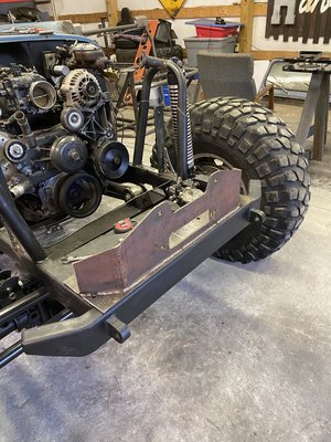

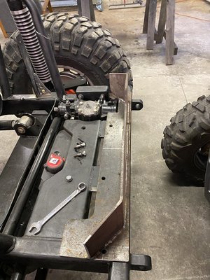

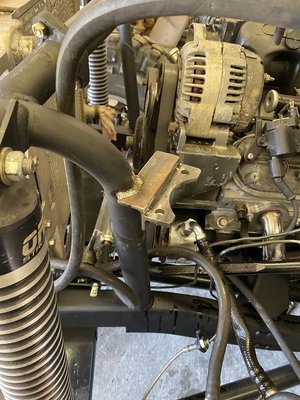

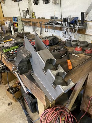

Well a 95* SC afternoon and about 2-1/2 hard hours on this winch plate cutting and welding. We have a removable mount. Couldn’t bring myself to have it welded directly on.... Lost one bolt hole to the raised steering box but wi have two in the center to make up for it.
3A3F43FE-B970-4DF1-B3E2-F85DA1E34E3F.jpeg DD443BFC-43B6-48F9-BABF-958146F4B66E.jpeg B641D293-C7C7-4FE5-9886-3C46AF54DA59.jpeg

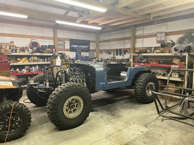

Looked back through this thread for the first time today while taking a break from paper work....
Holy crap this thing has changed a ton. Should have kept up with my hours on this build so I could have my feelings hurt in a few weeks...
Hoping for it to be running/yard driving by the end of the month (July)

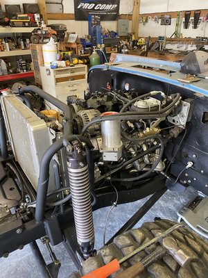

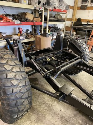

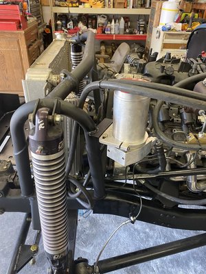

Got the steering reservoir/filter mount made and mounted on the shock tower, lines plumbed/routed, gas tank in place and holes drilled for the fuel lines.
Gonna hit the lake for the weekend and hop back on this project Sunday.
E9A51887-3A1A-4B40-929A-50B56BF74C23.jpeg A64ED0B1-54B7-4463-AD9B-93702ECE9719.jpeg 023B8B8B-D973-4F72-9D9F-455A5CDFB4CD.jpeg 88FA15CB-98DE-4EFC-A414-4D9F8DA6D29C.jpeg

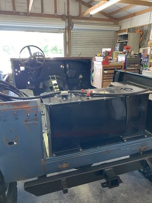

Fuel lines are made, pump actually mounted this time..., and trans cooler mounted to radiator along with lines made. Trying to decide how I’d like to hold the lines to the frame. Zip ties just don’t seem right...
