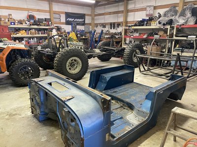

Took a couple of weeks off from the CJ to clear my head from work as well as the project. Work has been insane through this Coronavirus situation and the stress had started stacking up on me.

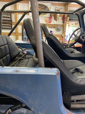

Dustin is bringing his bender over Thursday and we hope to get the remainder of the cage finished with seats mounted. I plan to get that complete and do the bedliner on the tub this weekend as long as the cage work goes as planned. Stay tuned...

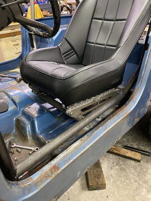

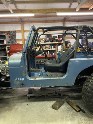

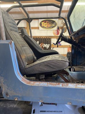

Turns out what’s the most comfortable is factory front height and a touch lower in the back to recline a touch. Puts me right at center of the windshield. Visibility seemed the best at this height.

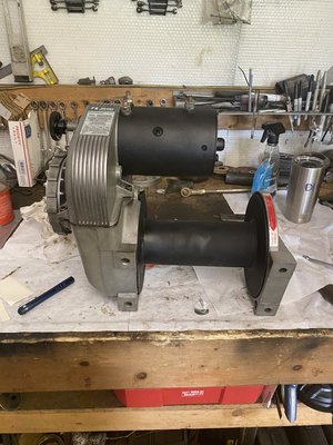

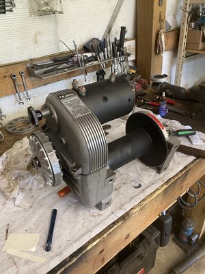

Today I got the winch re-assembled, lap belts in, and drive shafts measured. She’s getting there. One more big task is spraying the tub. Very ready to get that done. Hoping to do that this week/weekend.

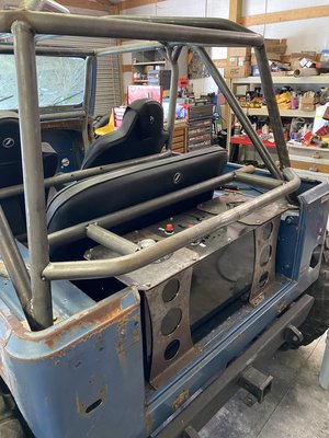

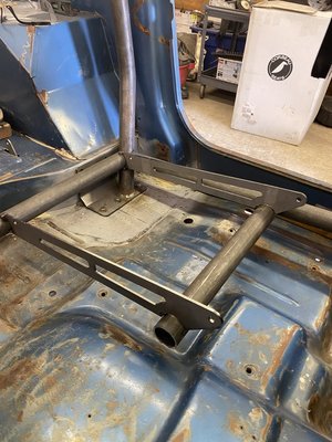

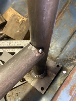

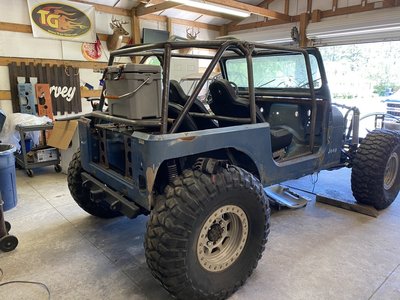

Got in the shop for a couple hours every night this week. Got the cage tie-in plates made up and bolted in. Got the B-pillar plates mocked up to the frame. Got one A-pillar mocked up and ran out of wire. It’s going to have to come off to fix the weld because it did some weird shit when the wire got to the end. Not sure how I want to tie the C-pillar in yet...
Also got the harness bar based out and the cooler rack bars figured out. Just have to take them to Dustins shop and bend them up. Looks like I’ll need about 5’ more DOM to finish🤦‍♂️

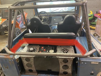

Going to utilize the harness bar provided by poison spyder and add a bar similar to what’s shown in red. This will give me a point to put the rear harness on as well. It will be just above the tank and I plan to dimple die a piece of 1/16 steel and weld it to the bottom side. With this plan it alleviate the need for a remote fuel filler. Probably will also kill any idea of a hard top but the most I’ll ever run is a soft top anyway I believe.
that should work well! will the rear bar (old harness bar) sit outside the tub some? if not why would a hardtop not fit?

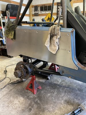

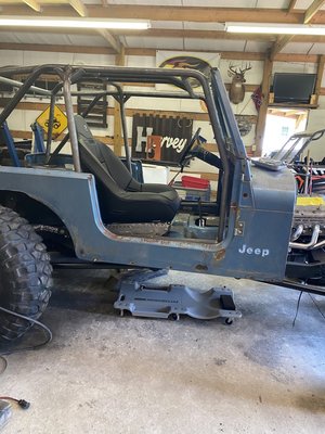

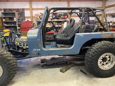

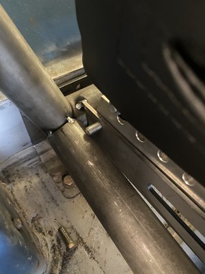

Made some stuff happen today. Missed the mark on my harness bar so had to improvise. She’s tight meow though. Gonna try to recruit some help to disassemble this bitch tomorrow.

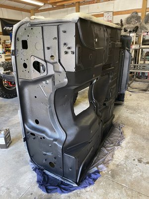

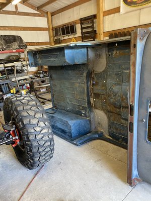

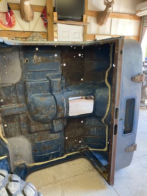

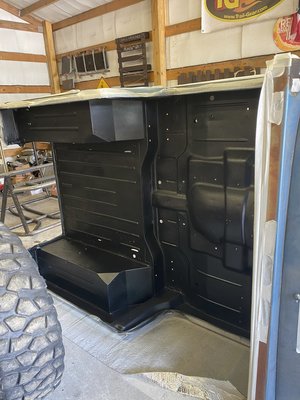

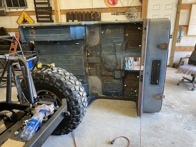

Fixed the last bit of rust in the tub, scuffed with a scotch brite on a die grinder, seam sealed everything, now To head to a wedding...
Plan to scuff everything by hand tomorrow, wipe down, and spray the bedliner.
Hoping to do a final nut and bolt, full fluids, and set the tub on Saturday/Sunday.
Cage goes to powered coat week after the 4th.
Boys, were about to have a CJ.
