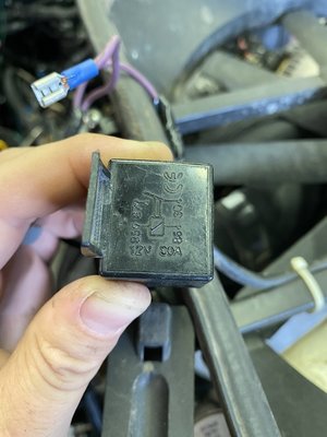

Fan issue fixed. Ran out of fuel before it got hot enough to trigger on by the ECM. Aux trigger works though so ECM should as well. Cleaned all the engine bay wiring back up.

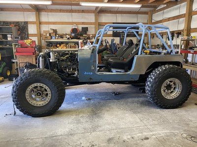

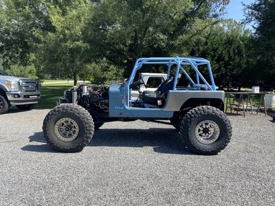

Mine should run and drive tomorrow. Charging the struts in the morning and have to bleed the brakes. Should be able to do some in shop wheel spin time on the jack stands and maybe make a lap around the block by the end of the day. Have to recruit someone to help with the brakes. I had them gravity bleeding and only one wheel came out.

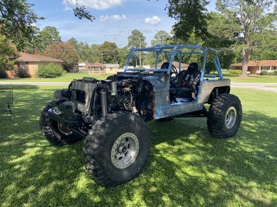

#RenegadeCJ got some vitamin D today on its own power. Brakes aren’t bleeding out great but they work. Going to try to get them 100% tomorrow and then just have to bolt everything on and clean up the dash wiring.
CBB5FE25-C01C-45E9-A587-81C36BE35159.jpeg 4AE8D84A-14DE-4E6C-8677-8639048E4A06.jpeg
