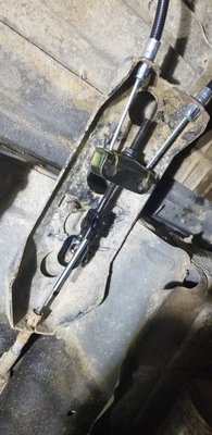

I splurged on ECGS Parking brake cables and new hardware to attach them to the lever.

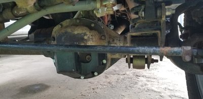

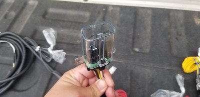

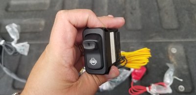

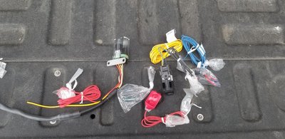

Picked up the jeep today, thanks to @LBarr2002 for taking me up that way! ELocker is installed awaiting my wiring job. I must say the kit they send to do the wiring is probably the best looking package I have ever seen...Also had an alignment done since I've put all adjustable control arms on.

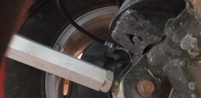

Got the ECGS parking brake cables in... Those things are nice.

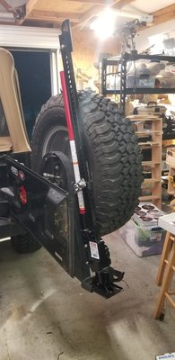

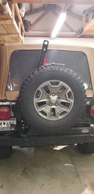

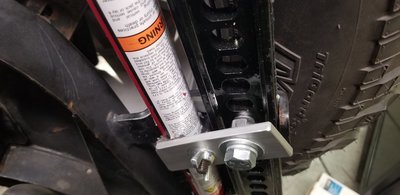

Also mounted the jack in the holder, blocks the tag but I only expect to run it on trips so I'll roll the dice...
