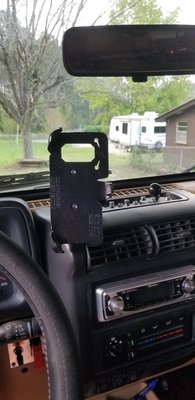

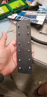

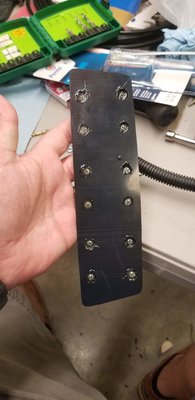

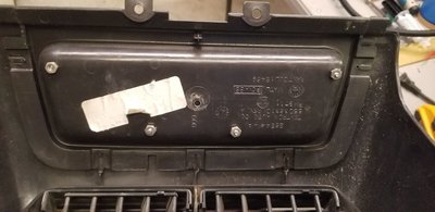

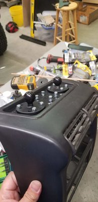

I fired up the CNC this afternoon and made a panel to mount in the dash tray for a couple of ram balls. I need to order a couple other parts from RAM to finish, but I'm happy for now.

I have broken 3 of those phone holders from that manufacturer, have you had good luck with them?
#65
I haven't used it personally yet, but lots of the guys I follow on YouTube do... Seem to have nothing but good things to say about them. I was looking into Ram before, but couldn't find one that I liked how it mounted.
#66
I think it looks like the 67d mount will work with Ram balls and arms from what I can see.
#68
I have never broken one, but i have also tweaked all of mine for a better fit.... The only thing i don't like about that 67 mount is not being fully retained. seems it might want to slide down with vibs.
I felt like all of mine felt pretty good, but the little tab broke off 3 of them.
