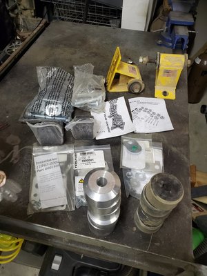

As discussed, I have the majority of 2 body lifts. When I do the raised body mounts you could have the complete plastic puck one or mix and match aluminum and plastic. I'm just using 5 of the aluminum packs.

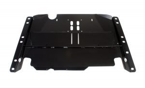

I think the conversation around the body lift is to retain the factory body isolation mounts and add a spacer or replace the body isolators with taller ones. I think @97TJGUZZY may be onto something with keeping rubber involved whenever possible. the belly up pan kit comes with a a shim to lift the engine, I would assume its enough to make the skid fit. It won't be completely flat, but exponentially higher up (marketing claims 2-2.75 inches. . 1648647401279.png 1648647409693.png

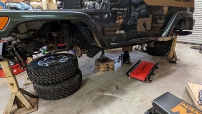

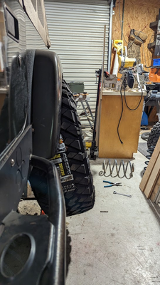

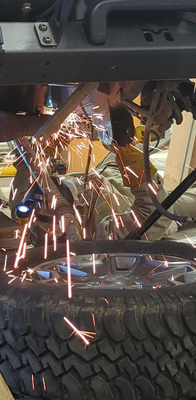

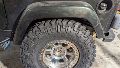

So a little status update. The suspension has all been installed, The rear is complete minus a driveshaft and bleeding the brakes. The front is hung on the control arms, but still ALOT of work left to do. Decided while i was rebuilding/upgrading to do the WJ knuckle conversion and a PSC Hydro assist. So lots of "figuring out" still left to do with the steering and track bar.
This was before getting the control arms set, its about perfectly centered.
