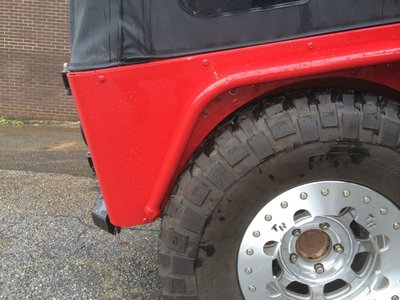

I cut the tub to about 1/4 from the armor, then folded it in and used the BFH to make it as close to a 90 as I could. It needs to be touched up with paint, but I want to see how everything clears before I paint the rear wheel wells and touch up the new cuts. But I like how it ended up.
I did hit the armor once (woops) but it is on the edge where stones are going to chip it up anyway. And honestly, none of it is going to be perfect in a week, so, close enough.

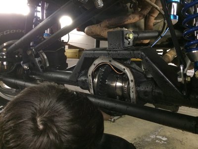

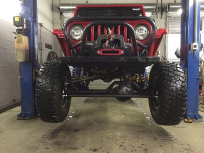

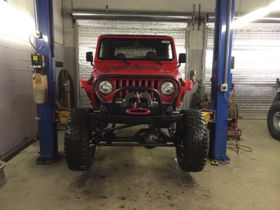

Jeep is on the lift for the last time getting the fluid changed in the front diff (after the breakin cycles). Getting all the bolts checked and she'll be ready to go.
WolfGT
Lol, my rear drive shaft was about to fall out. All the bolts holding it to the flange at the axle were barely finger tight.

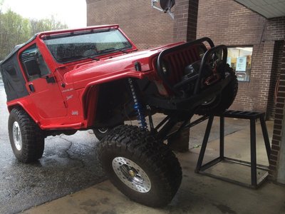

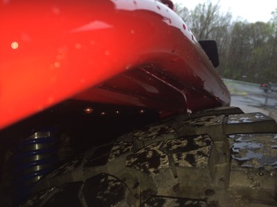

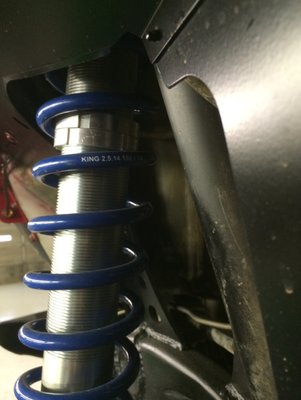

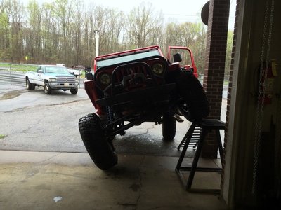

Flexed it out to see how close it comes to the new front fenders.
Looks good
Got about and inch or so clearance at full flex/bump. This is at almost full flex. The limit strap was not fully tight but almost.
But here is the new issue. This is the passenger rear during this test. Not binding, but rubbing pretty aggressively.

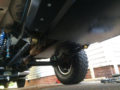

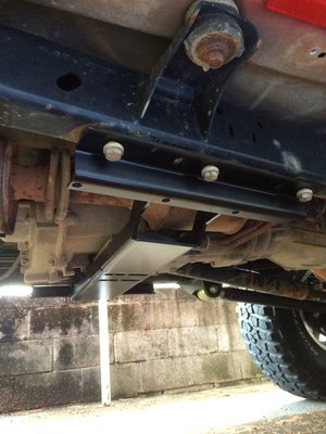

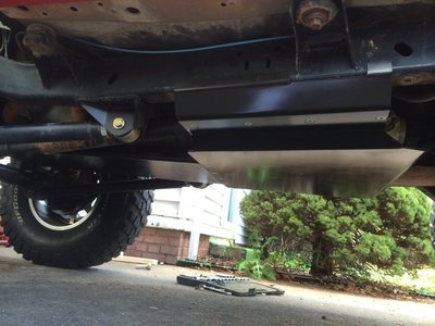

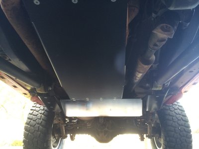

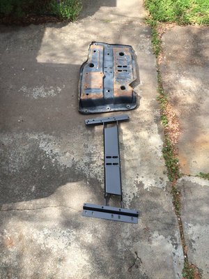

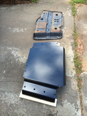

Got the skid plates installed. As with everything else, it didn't go as smoothly as I wanted. But it had nothing to do with the skid design. That thing is a beautiful piece of engineering. Props to Clayton Offroad.
Here is the old skid with the new trans support
The new trans support in place.
The old skid next to the new skid.
And a couple shots of everything installed.

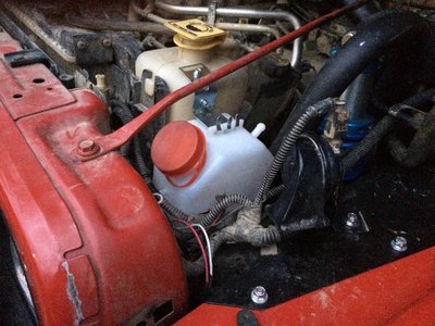

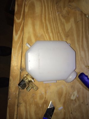

And just finished the last job that I wanted to get done before it goes on the trailer tomorrow. The windshield washer tank.
Of course the stock one would no longer fit due to the shock towers now residing in its stock location. And there is no room anywhere else for it. So I went to autozone and picked up one of these right off the shelf.
Took the pump off of the stock tank. It just pulls out and then remove the grommet that seals it to the tank. Cut a hole in the lower side of the tank and inserted it.
Then mounted it next to the coolant overflow tank with the provided bracket.
The stock wiring and tubing plugged right up and everything tested perfectly.
This was a quick 30 minute job and a cheap off the shelf part.
