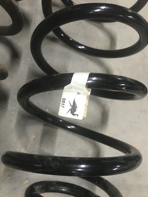

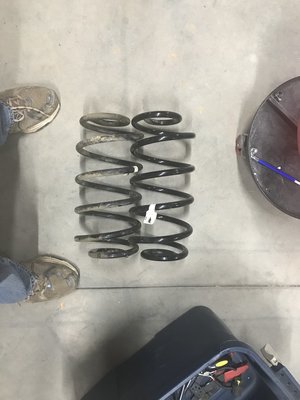

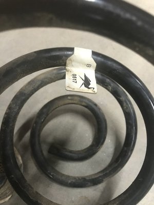

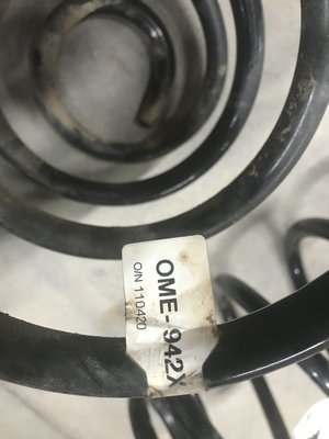

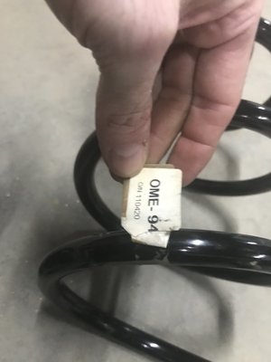

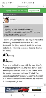

Well, I'm looking for input on what to do about the springs. By the instructions Larry found, I had it correct. So I see two options.
1. Put them back in the way they were and use the adjustments in the front to try to level it out (raise the front driver and lower the front passenger to try to shift the weight).
2. Swap them, this should get me closer to level and then use the front adjustments to get it right.
I measured the diameter of the coil wire and they are both the same. I'm not sure if they are different strengths or just different lengths. Let me know what you guys think. I have stopped for the night, the springs are still off.

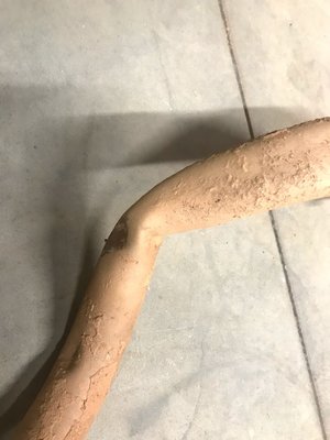

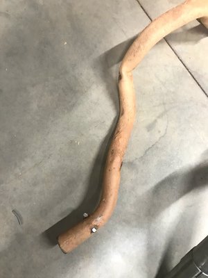

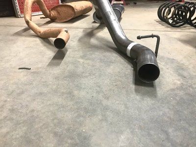

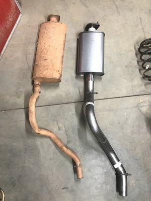

Since I had the springs off, I figured I would take the opportunity to swap the exhaust since it was nice and open. I dropped the skid plate and started to remove the old one. As expected, both of the bolts broke off when trying to remove the old muffler. No big deal. But here is a side by side comparison of the old and new.
And the awesome flow that I had. This added a ton of horsepower.

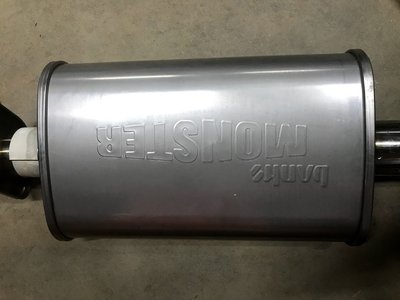

A little bit of a diameter difference.
