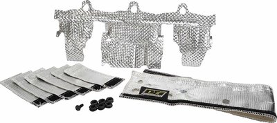

Interesting, that looks to be a fairly complete kit!

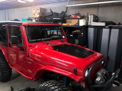

I'm pretty sure the combination of this and the vented hood, my spit and sputter issue on start when the engine is hot should go away. Honestly either of these two solution alone would probably fix the issue, but overkill is my method of choice.

But, you'll probably see an improvement with that insulation kit. Mine already had the insulation between the exhaust and intake. I wrapped the rail and injectors in DEI reflective tape (basically did as much as possible without pulling the rail) and it helped.
Have you already vented the hood? I would do the insulation first and see if you need it. Also, I have a genright louver set sitting on the bench I'm not going to use.
