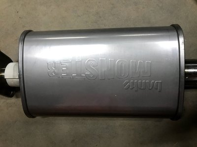

Since I had the springs off, I figured I would take the opportunity to swap the exhaust since it was nice and open. I dropped the skid plate and started to remove the old one. As expected, both of the bolts broke off when trying to remove the old muffler. No big deal. But here is a side by side comparison of the old and new.
And the awesome flow that I had. This added a ton of horsepower.
A little bit of a diameter difference.
Another Monster in my life.
