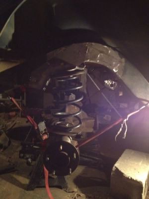

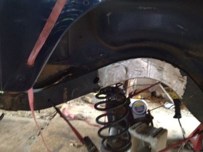

Installed the .5" bodylift in about 30 minutes start to finish, i spent more time sorting through the hardware then it took actually putting it all on. Its crazy when your dealing with so little room how much a .5" actually adds. It's pretty much exactly what i was wanting/needing, i couldn't imagine having another .75". I grinded pretty much everything i had left to do on the rear and welded up the spots where i had a boo boo. I mocked up the coil relocator in the rear and tacked it in to when i thought i had a nice position and placement for the axle and coil, pulled out the tape....94" so i obviously cut the tacks and moved it back. After some playing around i found a better location for the coilspring with the wheelbase set at about 99.5" with how it is now, it may change when all said and done. I think i jumped the gun when tacking the coilspring relocator brackets together awhile back as they are fitting the frame like crap so i need to fix that and burn them to the frame, possibly french them in a little if need be. what i'm using http://pirate4x4.com/forum/showpost.php?p=13062369&postcount=1
I got creative as i work alone and it was hard throwing that axle around by myself constantly, so i found some tie down straps within arms reach and strapped them to the frame so i could slide the axle easy and it still be supported

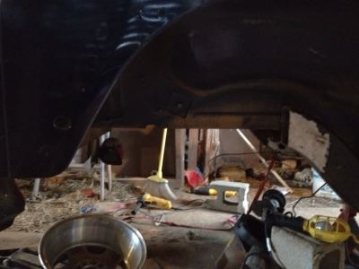

I've gotten nothing successful accomplished since being home..... I have all the links cut just need to finish welding them up. Front lower frame mounts are tacked on waiting until i build a truss for front to finish it then i will cycle and burn on in. Cut out the parts for the rear frame sections just need to notch the frame and cut the brace thing in the inner fender and see how it matches up then comes burning in the rear mounts.

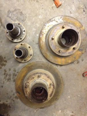

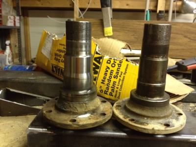

Decided to be like all the cool guys after i ran across this deal
Difference in small bearing and large bearing spindle, may try and take the large bearing spindles into class and turn them down for spares
Small bearing spindles with hubs and rotors i got for a pretty dang good deal. a spacer to convert rear is cheaper then shafts.

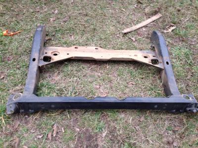

Also tacked up one side of my frame section, need to do the other side and burn it in i suppose. I fawkd up one thing with it so i'm going to have to fix it.

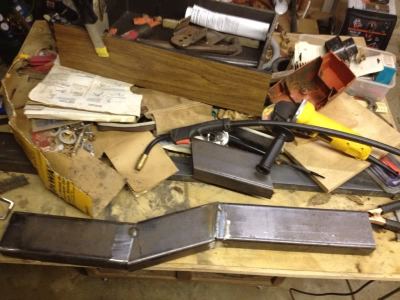

The frame part I posted a pic of is messed up, I need to fix because I blew through it. Probably going to try and run a backing strip or something for good penetration without blowing through.
