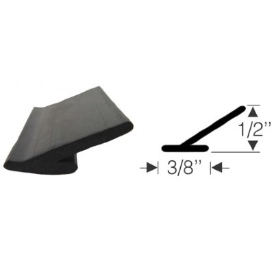

if you enclosed the inside of the fender i almost wouldn't worry about it. There are all kinds of weather/rubber seals in all kinds of different profiles out there you could use.
something like the second one is what I was thinking.
what do you mean by enclose the inside of the fender?

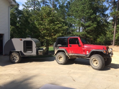

I ended up adjusting them on the trip and turned them down. When i first hooked them up the shoes needed some break in I guess. I had to turn it up to half way, but now that they are worn in some i have it at about 1/4" power on the dial.
So before you ding, bump, or bang it on the trail I suggest the completely mental approach. Pick an inconspicuous spot, whack it with a ball end of a hammer and you'll never worry about getting that first scratch or dent!
already took care of that, backed it into Tripps belt sander table in the garage and put a little ding in the back.

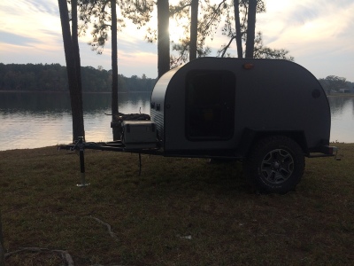

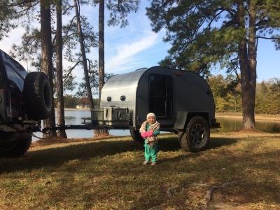

I have stayed in it 8 nights now and it's going to bard to sleep on the ground again. Ava loves it and Andrea likes how easy it is to get camp setup now.
I bought some bumpstops for it, but Im still torn as to whether I am going to install the 2" drop hanger on the front of the leaf spring or just do a spring over.
Been on a few more trips, It's been a fun project. Picked up a power tank propane mount for it I plan to mount behind the tire on the side.
Also did a spring over to get the tires out of the fenders.

Nice. Are you over 5 figures on this build? Courtney and I have considered something similar, were thinking about a roof rack and RTT on the teardrop. Love this thing though. Your little girl looks like she loves it!
