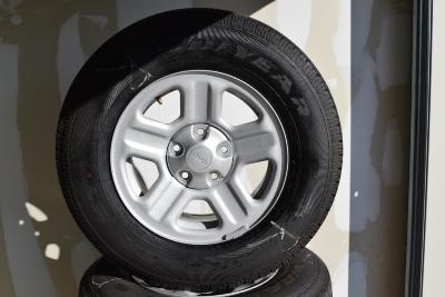

I have 5 of these wheels sans tires in the garage calling your name lol
Those are what I need on mine. The rims I bought because the price was right, but I didn't even thing about the backspacing. Now my steering is jacked up and it is crazy wide. Factory jeep wheels would narrow me up by a little over 3 inches.

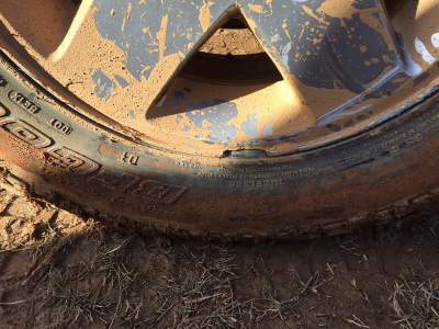

I thought it was worse, but I just found the picture. It did break the wheel, but doesn't look like it was an instant flat. But, you might have me convinced to run the moabs. $100 bucks for adapters is a lot nicer than buying new wheels. And it keeps the stockish sleeper look to it.

Hey that was my stock wheel after a quick go on the flats. Didn't break the bead, and I drove on that for 2 weeks. Broken beads with mud (HRD) and old tree root (Windrock). Still need to take these Maxxis off-road and see how they handle [emoji16]
