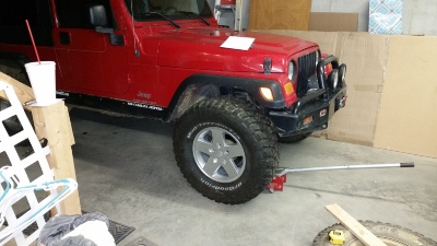

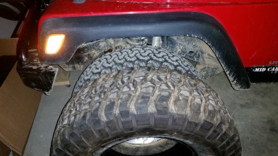

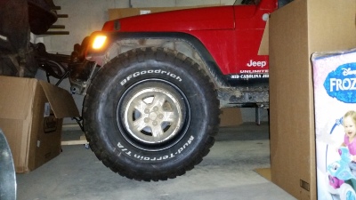

Before I go and buy a set of tires that may or may not fit, I picked up a pair of lightly used 35x12.50r17 KM2s. I'm going to mount them on the JK wheels to measure what thickness adapter/spacer I need and see if anything else will be needed to fit them.
They look HUGE!
Mainly putting this here for my future reference, but the overall backspace with the Ravines and 33x10.50 (straight edge across back of tire and measured to wheel mount surface, so backspace of wheel/tire combo, not just wheel) is 6 3/8", and the overall width is 10 3/4".
The JK Moab with 35x12.50 is 7 3/4" overall backspace and 12" total width.
The Ravine and 33 combo rubs on the spring buckets a little, so I think I'm going to go with a 1 1/2" spacer/adapter which will give me an 1/8" more inner clearance. If it still rubs, I can adjust the steering stops a little.
