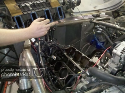

Started the motor today. Runs great. Sounds like a middle school percussion band is playin hells bells in the valve train though. Apparently the place I bought the cam from decided they shouldn't tell me I also need longer push rods as the cam is cut different. Thankfully, there will have been no harm done by this and I can get some pushrods changed and it should be good to go. Man, that was a sickening feeling all afternoon though... I will say, this thing seems stronger than I thought it would, even with the issues. Ready to get it right and see what it's gonna sound like.

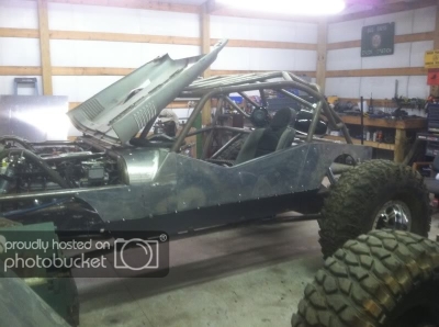

Well, the to-do list is steadily decreasing:
Install coil springs
Charge shocks/bumps
Finish passengers side skid
Finish trans/t-case skid
Mount lights on front
Lights on back (if I do any)
Mount amp and computer
Re-install rear diff cover
Top off everything with fluids
Re-tighten all bolts and replace some with lock washers/nuts
Sounds like a lot, but should be ready to roll out this weekend if all goes as planned.
