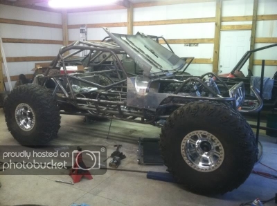

Plan on having it ready in March actually. All the "big" stuff will be done this week and hopefully I can put it all back in next weekend and then start plumbing/wiring. Then im on the home stretch.

Oh she will be ready. I figure I have 2 Months before Harlan and would like to have it finished in a month. Puttin cam in in the morning, hope to have everything back in this week. Planned on having trans looked over by now but the guy doing it was hard to get in contact with. Dropping it off tom., hopefully he will look over it fast. We will see what happens though. If it's not done I have other options for a ride thankfully.
#71

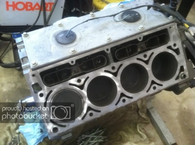

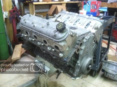

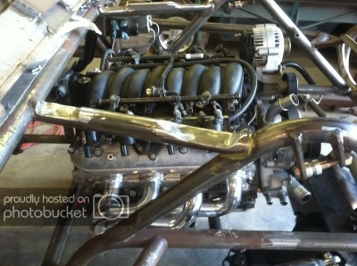

Minor setback on original motor install plans. The intake gaskets didn't get there in time so we will be putting everyting back in this weekend hopefully. George has one of my axles done so if they are both done by the weekend I will put them in first. Brian is coming back down with a newer LS1 intake Saturday and hopefully I can have everything in Sundayish.

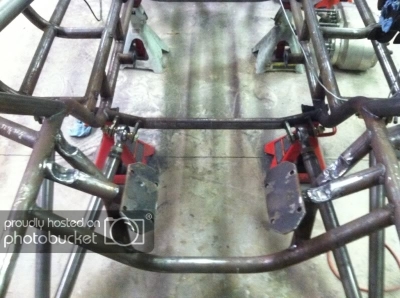

We welded up a few welds on the chassis tonight that were unable to be done by the builder with motor/trans/cases in it tonight and smoothed everything out that wasn't smooth. Also notched the motor mounts for headers. The only block hugger headers I could find that came straght down required this. Beats having custom headers built though, and everything will fit nicely now.

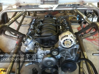

Motor and axles are back in. Hope to have the rest back in tomorrow and then start some wiring and plumbing. Then to tie up the MANY loose ends.
#75

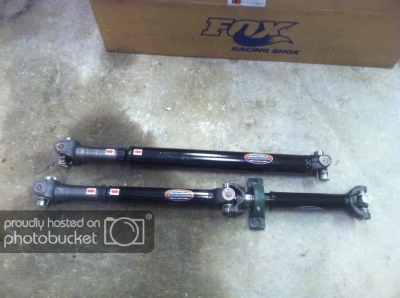

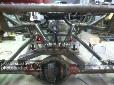

It's back on it's own weight, drive shafts in, air bumps mounted, axles finished (except for front gotta tighten spindle nuts). It's coming together now... We are gonna try to have the wiring mostly done tomorrow along with some other minor things on the list.

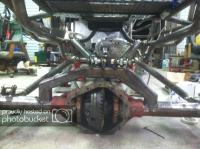

Barnes shaved diff kit is crucial. Didn't wanna have to machine the ring gear and it was cheap. Fit pretty shitty but we got it on the other night. No pics of it on though. Gives me 13.5" of ground clearance at the diff with 42's. I'll take it...
This is sitting at full bump and front tire is just rolled up as I have not tightened the spindle nuts yet.

The to-do list keeps dwindling down. Got the fuel system buttoned up tonight, steering cooler in place, and wiring finished. It feels good to say theres only a hand full of things to do before it can be cranked and driven. There will probably be a good days worth of tuning the shifters and tightening bolts next week and I hope to go ride somewhere after that.
