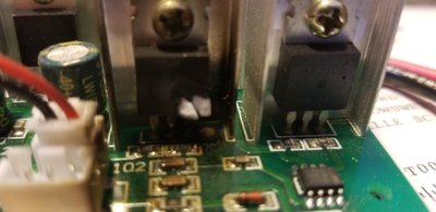

After my test I opened up the problem controller and found two of the primary capacitors flopping around. It looks like it either got hot enough to flow the solder off or their quality control is absolute crap. I can't return it for a warranty return now that I opened it, but it was $25 and I am sure shipping would have been 10-15 so I am not worried.

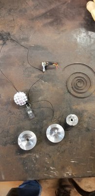

I was really excited for shop time tonight. I had a plan to make a string potentiometer for the throttle pedal. Some light aluminium machine work and everything looked like it might work. I used the string and spring from a badge holder. Machined a few simple pieces and it was done. Only the spring isn't strong enough to turn the potentiometer that came with the new speed controller. Plan Z upcoming.

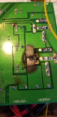

Just keep letting the smoke out. Motors are 24V 350w. I have smoked multiple controllers now. The latest is a 60A controller! Do I waste the money on another gamble at 100A or just buy brushless or gas to power it?
