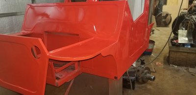

A bunch of sanding and a recoat. Thinned less and opened up my needle a little more. Much better results. I am not happy with the amount of dirt in the paint and you can still see a few of the runs, but it is a toy for my kids and it is time to enjoy it. I will let the paint cure for a couple days while I work on the seat and rolling in some bed liner. Maybe next weekend I will do final assembly with my son and let him enjoy it.

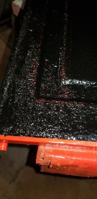

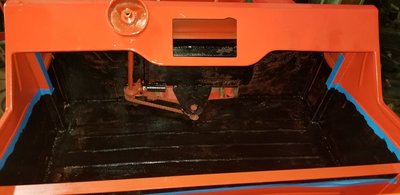

I learned tonight that Rustoleum bed liner is allergic to Rustoleum paint. It is the equivalent of putting aircraft remover on the paint. Lots of cleanup and then another round of liner?

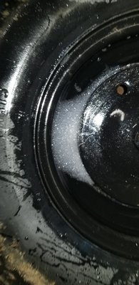

The wheel no longer leaks. I tried welding. I tried grinding and welding. I tried welding again. I can really quickly break the tire down now. In the end I used RTV and let it set a little. Then cranked up the pressure to set it in the pin hole.

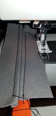

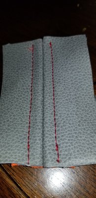

Practicing my sewing to build the seat. #frenchseam
