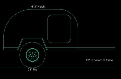

If it were me, in the interest of getting it done on time, I'd let the builder do whatever he normally does and change it later if you don't like it. Your tires are outside the tub so height doesn't matter for tire clearance. I know you're shooting for the max height of 6', but if it's a little taller than that it's not the end of the world, and once you have it in your hands you can decide if it needs to be changed.
#31
spoke with him this morning about it, I brought up that exact thing. That a few inches wont make or break it. We are looking at a roof height of 6'-3". They did order the axle a few days ago so its a done deal.
#35
You could do away with the "fenders" and make the width of body increase for more room and make the body come out to the edge of the tires, then make a "plate" bolt to the body to cover the upper part of the tire for safety.
Like the military trailer but just have the plate cover the tire a bit.
#36

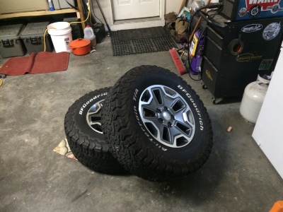

It's already wider than I wanted haha, any wider and I'll knock every corner off on the trail. I manhandled the tires on today.
