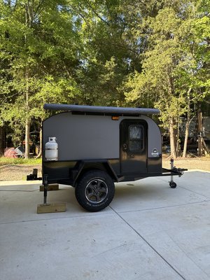

Got back from the trip and noticed I had a little bit of new camber on the trailer. Jacked it up and found the pivot bushings are worn out. Called Timbren yesterday and they confirmed it looked worn out, but said it shouldn't be with only 10k miles on it. They are sending me an updated set of control arms free of charge to fix it up.
hopefully the new design will fix the problem for a long while.
#26
Timbren sent me both swingarms and I replaced them last fall. We’ve been rocking and rolling in this thing since then.
I did notice that I need to tweak the alignment of the spindles after I installed the new arms. The spindle bolts onto the arm and has some room for alignment.
