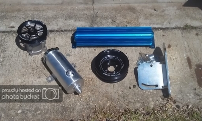

Nah...I considered it a few weeks ago, but I ordered these parts last Friday and had them 3 day'd to me. I would've needed to order by Thursday in order to have enough time for full hydro...lol. I love last minute projects. I was tired of the stock Toyota pump not having enough balls to work correctly so I bit the bullet and picked up the 1,450psi 4gpm pump, bracket, and 12" heat sink cooler. I also decided to ditch the V-belt in favor of the 4 rib serpentine to help prevent belt slippage and squealing.
The heat sink cooler in the pic had a problem though. One of the brackets was fully welded and the other only had one small tack weld on it. Being aluminum I couldn't fix it myself so I called up Low Range Off Road and they stuck another one in the mail via overnight UPS so I'll have it today. If you EVER need anything for a Samurai or Toyota rig you shouldn't hesitate to call (call versus using the site) LRO...they've always taken good care of me!
