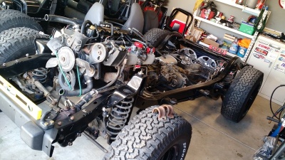

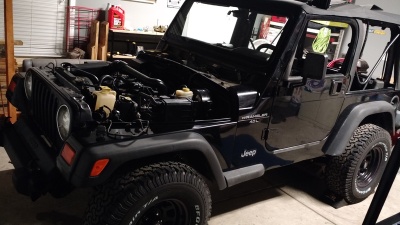

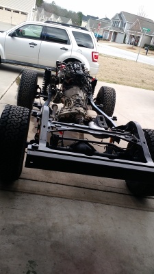

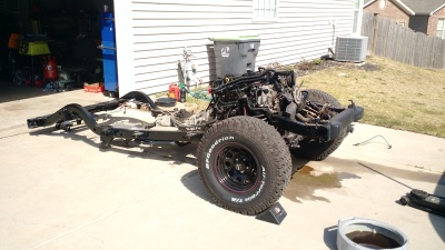

I took Friday off from work to get a head start. Friday mainly consisted of installing the axles, running brake lines and basically everything else that needed to be on the frame before dropping the tub on it.

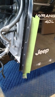

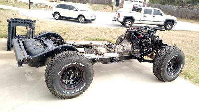

Got another early start today - had a few things to address before installing the tub. Tub is currently on the frame with new body bolts. I ran a tap in each threaded hole and anti-seized the bolts.
Main things left to do: install front end, bleed brakes, add p/s fluid
I also had a stupid moment on Friday. I tripped while walking around the frame, but caught myself by the radiator which shoved it into the fan blade... so I have a new radiator now.
Front axle in!
Rear in
Tucked away for the evening

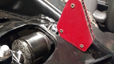

A nut for the rear shocks decided to split ways... so welded a nut on the frame
Body is ready to go on
And it's on...

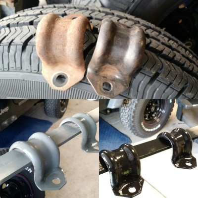

There has been lots of painting on this project...

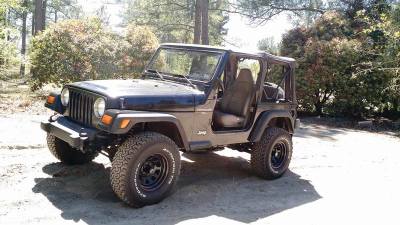

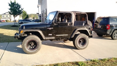

I finished the lift about a week or two ago. I think it turned out pretty well and all for less than $300. I wound up using 2" pro comp springs and JK shocks. Also installed front/rear track bar relocation brackets and bar pin eliminators.
The bolt for the axle side of the track bar was seized in the bushing. I had to cut off the bolt head and use a reciprocating saw to cut the bolt between the bracket and the bar. A BIG thanks to Larry for hooking me up with another track bar!
#55
How is the ride compared to stick with the jk shocks?
It almost feels like the ride my JK had.

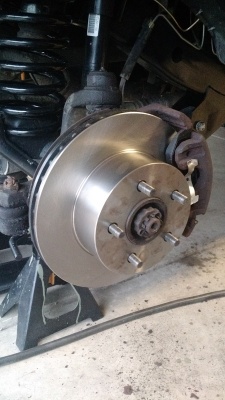

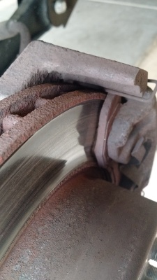

Last night I changed out the front brake rotors and pads. It was time.
Then this happened on the way to work this morning...
[video=youtube;dYrtR65y9m0]https://www.youtube.com/watch?v=dYrtR65y9m0[/video]
