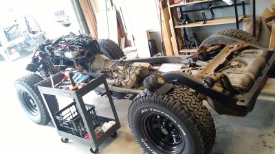

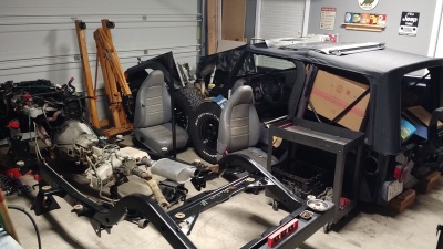

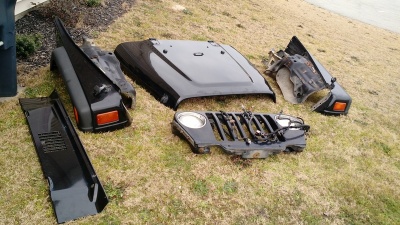

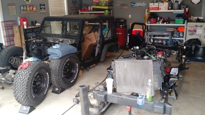

I made lots of progress this weekend. I always have good intentions of documenting my projects, but as usual, I forgot to take pics... So here's a few pics of the progress.
I was hoping to not open a can of worms with this project. Everything has gone relatively smooth so far. There was only 1 victim of the entire process - a sway bar link broke.
I have a few things I need to get done before reassembly:
  • install new brake lines
  • clean up the skid plate
  • buy some new bolts
  • clean up and paint various parts

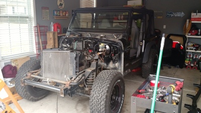

I removed the front end on Saturday morning.

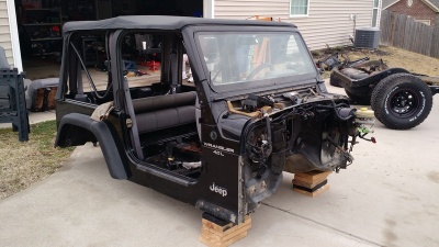

Body is off, time to pull the engine, trans and tcase.

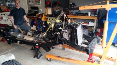

Engine, trans and tcase installed on new frame (excuse my brother)
Body sans frame

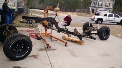

Time to pull the axles off the old frame

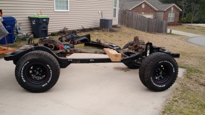

Old frame is stripped!
This is what it looks like when a Wrangler explodes in your garage.

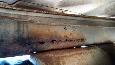

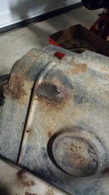

#27
I'll have to take a few photos of it tonight. It has some pretty bad spots and had been patched already.
Edit: here's one I found on my phone
#30
Yeah... that's pretty bad. Where did it come from? Tripp said you found some other issues like brake lines?
It came from an older lady in Virginia Beach. I discovered the lines were rusted really bad by the shock towers when I took off the inner fenders. So I'm replacing all of the brake line. The fuel line was fine. There are a few other parts I'm going to replace while I have it torn apart.
