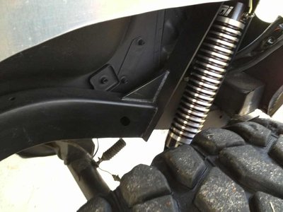

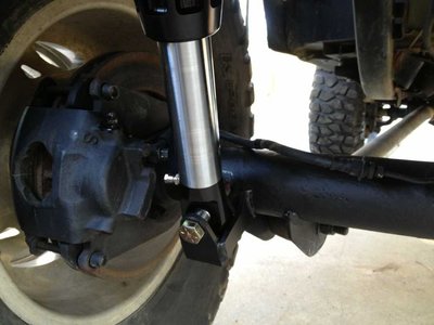

Diggin' the **** out of the ORI's. The body roll was zero. We got up to some good speed also. Glad mean green is bout ready for the trail. See ya wed. with bootleg in hand. C'mawn....
Looks awesome nick. I must say hella impressed with them fitting with no binds like they did without mocking them up and cycling.
Did you or are you gonna cut that cross member out before the trip or that happening when the cell goes in I forget?
shhhhhhhh........I mocked them up. Just in my head. No, not gonna mess with the crossmember until my kids are grown up. That will probably be the next time I can go wheeling. This will be my last trip for a while so glad its OSCAR! Cmawn??

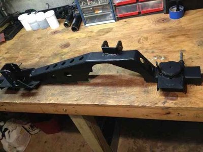

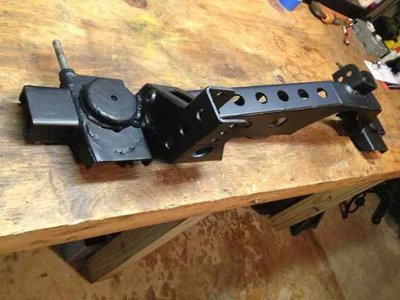

Real updates coming soon. I got a new used truss from Will today. Thx for bringing it back DeMarcus. ImageUploadedByTapatalk1367720022.118468.jpg
Here's the truss I stole. Thx Will.
Dang Nick, you work quick. Already cleaned it up and shot it with a fresh coat of paint. Cut those limit strap tabs off of the coil buckets and you'll be good to go. Not sure how much front stretch you have on your rig at the moment, but the buckets were moved to compensate for a 2"-3" front stretch while keeping the springs from bowing. Enjoy, hope it works for you with out too much tweaking.

Yea I noticed how the coils were moved back. That's going to be great as mine are bowed like crazy with the front stretch. There was a lot of grinding on the top of this girl son.
