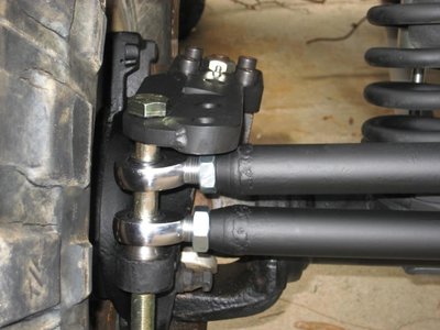

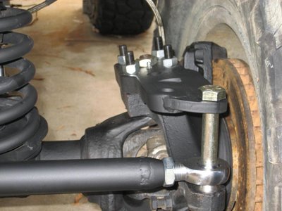

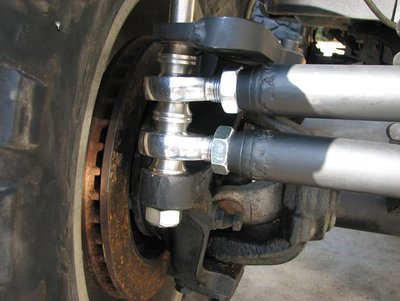

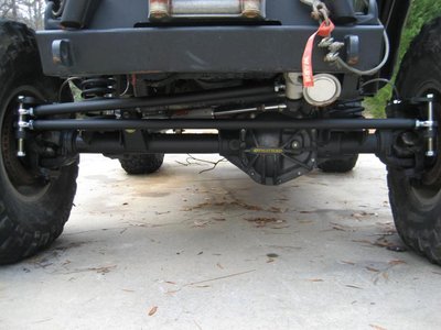

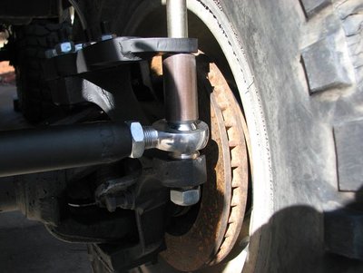

I built the links yesterday and mocked everything up today. I think it turned out good. I still have to cut the spacers to seperate the hiems on the pass side and cut one for above the driver side. The 10" bolts look rediculous but they are just temporary. I didnt get any time to look at the hydro ram but I think it will be easier to mount this way. Maybe to the drag link.

Thats a good question. Its not as close as the pic makes it look and I have not even cut the spacers so thats not necessarily where it will be. I just have something behind it holdong it up for the pic. I will definately look into that though. It seems like my old setup was very close too. Looking at these pics did just make me realize that I forgot to cycle the steering before it got dark. I'm can guarentee that it will hit my trackbar bracket that I just recently installed. I'm going to get some gas and matches now and torch this pos.

I cut the spacer for the driver side today.
Then I just stacked some misalignments on the pass side so that at some point I can test flex it to see if the high steer arm hits the drag link. Its funny because in person it looks ok but in the pics it looks like its already hitting.

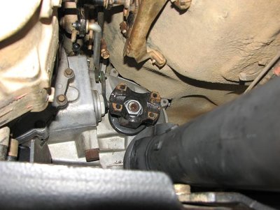

I installed the front driveshaft and it was hitting the transfer case shifter bracket at the rear so I just cut off the back lower portion of the bracket so its a three legged bracket now. I think it will be ok but certainly not a permanent fix. I believe I will lengthen the front driveshat as well because there was only 2" of slip left in it before it would seperate.
