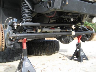

#32
Here is the current setup that I'm changing. One of the knuckle tapers was so bad that I just decieded to go with heims over the knuckle. I'm also moving the drag link down a bit right above the tie rod in double sheer so that I can lower the front of the Jeep down an inch. This Tie Rod with the offset rod ends is for sale along with the drag link if anyone is looking. The offset rod ends have 3 hours on them and the drag link TRE has one!

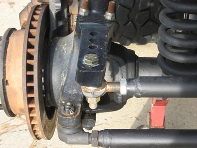

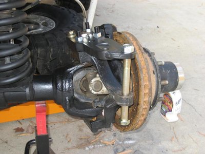

The PSC arm will also be for sale. This is the new setup and a pic of the passenger side mocked up. I have to clean the threads on one of the stud holes and decide whether that gasket is needed or not. Does anyone know if the springless stud on these arms is supposed to be torqued to a certain spec on the upper kingpin bushing?
#33
Looking good Nick. The center bolt for the springless set up does not have a specific torque spec. You basically snug it down until it takes a little force to to move the knuckle. They're fully tweakable to your liking, but the tighter you run them the quicker the bushings will wear out. As for the gasket, I ran one. The gasket makes up for any imperfections in the mating surfaces. In regards to extracting the seized studs, use PB and/or heat and a big *** pipe wrench (just don't plan on reusing them). I always install the new studs using the double nut method and use red thread locker in the knuckle holes. I'm surprised that artec didn't send you shorter bolts with that set up, those look to be the same length as the ones I have with my reids.
#34
Thx Will. Yea I meant to mention that bolt length to you. I was surprised too. I was just going to have to run some of the leftover spacer on top of the arm to make up for the extra length of the bolt because it will not work as is. I'm a little concerned because one of the knuckle tapers was so bad that I barely had to touch it with a 3/4 drill bit to go through. I hope its enough to remain solid. I bet they sent me the wrong bolt. I'm gonna check out their site again because I do remember selecting stock Ford knuckle.

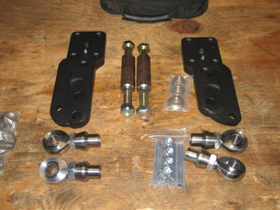

I doubt it is the ballistic arms as the only thickness difference is that the artec arms are the same 1/2" thickness all the way around where the ballistics taper down to go to the outer knuckle hole piece. So the only real length differences are between the ford knuckles and the chevy/reid knuckles, which it appears that they sent you the correct length sleeves for the ford knuckles. They might be expecting you to cut the extra 1-2 inches of threaded portion off, but it kind of looks like there isn't enough thread to tighten the bolt all of the way down. I would give Nate or Artie a call in the am and let them know your concerns. They have sent me different brackets than the ones I have ordered before, and when I let them now they just sent me the correct brackets. So ended up with some free brackets that I didn't need, but I thought it was pretty cool of them. Let me know what they tell you.
Edit: Are those misalignment spacers and a safety washer in the little baggie in your pic or where those something that came with the knuckle bolts?
#37
Yea the spacer is almost the same length as the area between and you are correct, the threaded portion is not long enough. Yes those are just some miscellaneous spacers in 3/4 that I got with the Hiems just in case needed to squeeze the drag link hiem right below the arm. I may not need them but like to have stuff like that just in case. No high misalignment though, just standard.

Cool deal, glad it worked out. FYI, you should have gotten 8" bolts with you knuckle bolts instead of the 10" ones that you have. I had to call artec today to send me some bolts that didn't make it into the box in my last order, so they're throwing your 8" bolts in there too. Will let you know when they show so we can see if someone is headed either direction from Columbia to Greenwood.
#40
