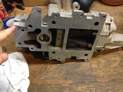

Well I fired it up today. Idled fine but it had a wicked backfire under throttle. I also noticed that I could not hear it sucking air at the filter. There are some ports on the bottom of blower that I should have siliconed off. Shouldn't be too bad to remove and redo. Hopefully that fixes it. That banks header makes it sound a lot better at idle.
I would not silicon off any holes....plug them the right way or they will just blow out under boost...you have a wide band on it?? That will keep u from blowing your motor up while tuning it
Sent from my DROID BIONIC

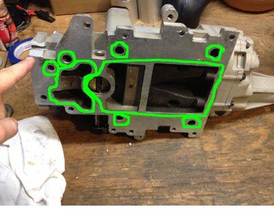

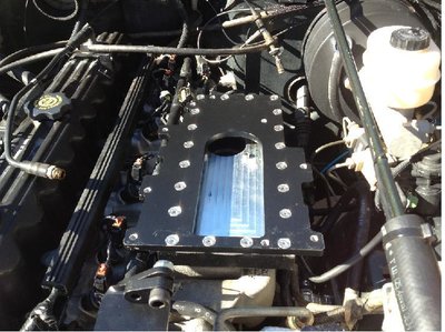

Robbie, the ports are rather large. In this pic, it's all the small circle ports that do not get used anymore. They all will now be secured on top of the intake adapter plate. I was just going to run a bead around each one as it gets plated off anyways.
This pic is of a damaged blower that ups dropped.

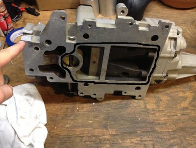

Thx Robbie.
What I did.
And what I believe I should have done.
The opening in the adapter plate is only open where the three large openings starting from butterfly and continuing to the right.
Split Second has already pre-calibrated the tables. I should not need to have it tuned unless searching for more hp. Which I would like to do eventually.
I just got off the phone with the guy that builds the kits. He seems to think vacuum is not an issue and told me a few test to do. It may even be fine. I will keep ya posted. I guess Im gonn drive the ole lady today and see.
