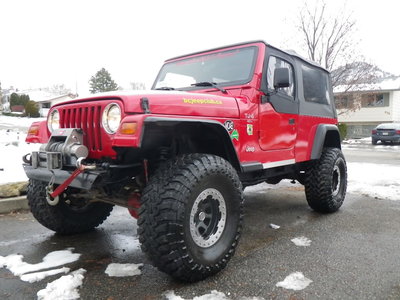

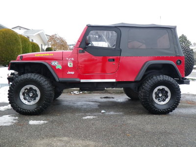

So guzzy has been the same for a few years, but I have always wanted to stretch it out. And with a kid and dogs, space inside has always come at a premium. After paying off the JK, its time to start. My plan is 108" wb in TJ6 style package. I was originally planning something like ken Shupee did back in the day to the TJ that Barclay bought. But I recently found an LJ tub that I'm hoping is a good candidate. I am working through aquiring the rest of the parts.
Jeep LJ Tub
15" frame stretch
LJ PSC daddy long legs Rockers and Corner armor
The goal is to have an LJ length tub with a TJ rear overhang. This will give me a bit longer belly, but its still 8 inches shorter than a JKU.
