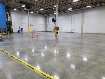

So, they pressure washed multiple areas of the garage and took off the smooth top where they were trying to get drywall mud off. Anyone have any suggestions for a fix for the floor other than breaking it all up and re pouring? I'm avoiding epoxy coating because I can't weld on it. Are there any weld rated garage floor coatings?
Could you do a thin skim coat? I know new concrete doesn't typically bond well to cured concrete...
yeah, i havent seen any reports of that being a good long term solution. I'm looking at possibly a grind and seal, it may be a good option.
headed by there tonight to look at some stain samples they dropped off.
whats the maintenance like on floors like this? I don't really care that they are glossy. I think this would hold up best to welding and stuff.
It basically like any other concrete surface. It actually cleans up a bit easier. It is still porous, but not as much as bare concrete. The gloss finish needs to be burnished about once a year, if you want to keep it.
They have been scrubbing their mistakes for the past week, I went by this morning and it looked 98% clean. They are supposed to be writing up our acceptance contract today and sending to us for review. Hoping to close out next week. Fingers crossed!
Still working on it I see.
this is an older photo from a few weeks ago. We are hopefully wrapping everything up next week.
