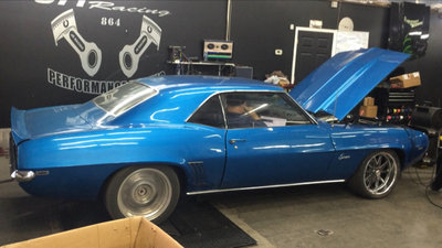

Took the car to Greenville today. Put down 443HP and 376 FT-LB TQ on the rollers. I was hoping for a little more but am still happy with those numbers. Very curious what the thing is going to weigh now....
