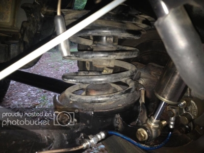

shows the need for some bumpstops. its better than my shocks bein bottomed out though!

Did you put anything on the coil to keep it from falling out? I made some small straps for the axle side and it keeps the coil from coming out of the bucket.

alright one second i'll snap one, and thanks for the constructive criticism. post up a picture of how your coils are retained too please marcus. and i will add that piece at some point brooks, my uncle didn't have quite enough scrap to built the truss to put that piece on.

I did somthing like this to retain the coils. They are only 10 bucks from Rustys but I made them out of some flat steel I had laying around and bolted it to the axle bucket.
I just extended the stock bumpstops with some scrap peices of DOM I had laying around. Since Im running ZJ coils they wont come off the bumpstop. The crappy yellow shocks are not under there anymore tho.
