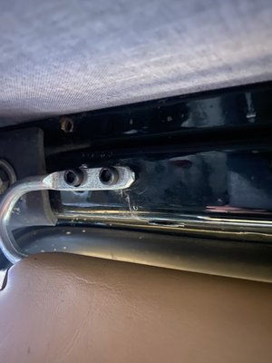

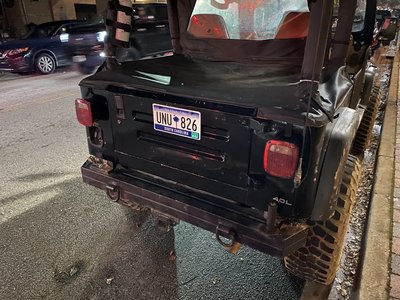

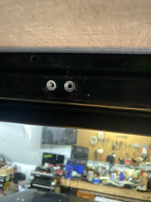

Well apparently YJs and CJs have their sun visors attached with sheet metal screws and it's a crap design that just leads to bigger and bigger ones that keep falling out. Stuck some rivnuts in the windshield frame last night and bolted those suckers on. Problem solved. Also took off the loud squeaky tore carrier that puts the tire dead in my field of vision.
View attachment 22312 View attachment 22313 View attachment 22314
I love rivnuts.

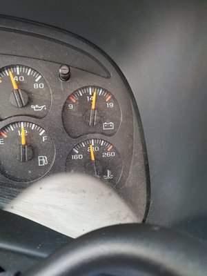

Burgundy's yukon xl has not been getting up to operating temp the past few weeks. We have a 1200 mile round trip coming up and would rather drive hers at ~20mpg vs mine at ~12. I could just pop a new thermostat in it, but that would be too easy and it has 210k miles on original water pump.

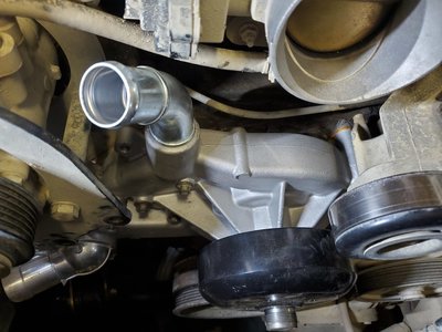

I've had a Flowkooler pump for the jeep sitting on the bench for months, and it's thermostat housing has been leaking a little. I guess this is the motivation I need. Today's project was Flowkooler pump on the jeep. Tomorrow will be putting the 3,500 mile oem replacement pump from the jeep on hers.
The addition of AC made this much more difficult. I couldn't get the pump out without either removing the AC compressor or the fan. Ended up wiggling it out the bottom.

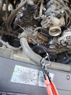

Second one done. This was one of those jobs where the right tool makes all the difference. I swore after doing the radiator in my 2500 I wasn't messing with another one without hose clamp tools.
The original thermostat looked perfect, but the spring was soft. I could start to open it by hand.

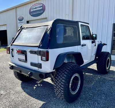

meant to take pics but forgot. Helped my brother put a 2" AEV lift on their JLU and he helped me throw in the 3/4" daystar pucks in the back of our Gladiator. It raked it out just a bit so it doesn't look so saggy out back.
