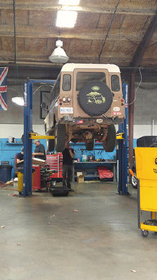

After fixing 3 out of 4 of the dash gauges (that sucked), new speedometer cable, shift kit, tearing apart the entire interior, rebuilding the hub and spindle, replacing the seat belts, and re-working the vacuum lines, I've had enough. Took the 109 to a repair shop to get the front main seal replaced (REALLY didn't want to do that), adjust the valves (always fail at that), and the fuel sending unit (really didn't want to do that). Works well as I've been gone a lot for work so its worth it just to keep things moving even when I'm gone. When I get it back next week, I just need to check the fluids and pack.
Overall right now, I'm just spending a bunch of time on the details. Its annoying but fixing all of the little nagging things that piss me off is pretty huge. Hopefully it'll be ready for a road trip to the beach next weekend and then Uwharrie at the beginning of April.

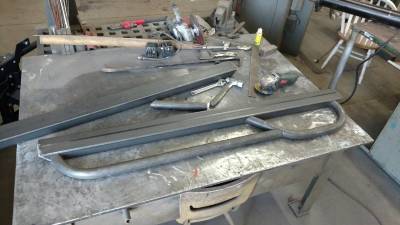

My power steering kit came in the mail yesterday, pretty nice kit with very detailed instructions, can't wait to get started
Started working on the power steering conversion, inner fender pulls out very easy
surprising the pitman arm pulled off quite nicely
the steering shaft is part of the steering box, little sawsall action will take care of that

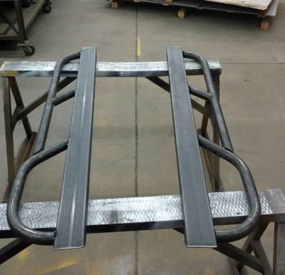

test fit the new mount
thats a hell of a bracket!
