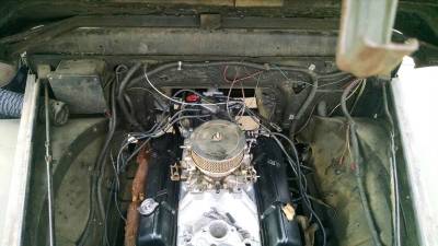

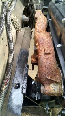

Ok, so my headers will not fit between the frame rails on the m37, so I had to go old school with a set of center drop ram horn manifolds, carb and distributer are in, getting down to the short list now. Will not be long before I fire it up 104e1e8667b026a5aadc213e3ca84b8c.jpg 0a0def4d818bededeabe22b99d9b1cb8.jpg

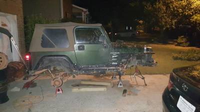

In an effort to get the tires out of the fenders and flares on Melissa's XJ I put 1.5" wheel spacers all around and this weekend I swapped the stock coils on the front for a set of v8 zj springs I got from Kirby way back in the day. Guessing the front has about 2-2.5" now between coils and a spacer. I have a set of lower adjustable arms I need to replace bushings in and I plan to swap in, also when I get time I need to do shackles in the rear. Just hit 200k, she's had it since she was 15 and her dad had it before her. Been a nice jeep, just gets warm in the dead of summer which I've been trying to battle.

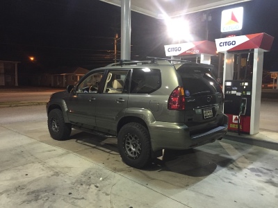

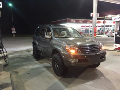

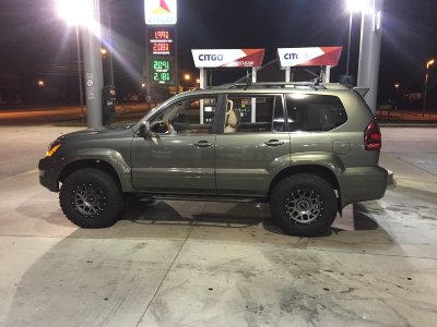

Got the lift on the GX. It had a lot of rake so I did a toytec 2.5" in the front and adjusted the air ride for an inchish in the rear. Rides fantastic, the adaptable suspension still works in all its settings and I still have full range of air ride in the back. ea5597c7314fa9a743df42d6dd3661c9.jpg

what bumper did you order for it?

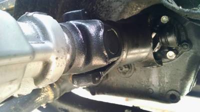

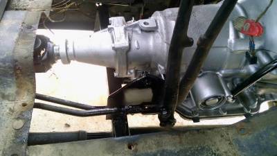

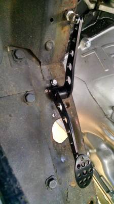

I got my mid shaft finished and installed, now I need to pull it back out and have Carolina driveline make a new one and i will keep that one as a spare, t-case shifters installed and new accelerator pedal 474820f74885b2f504e7d1627ca3d154.jpg 0717bc9d446d7972de055fddb6c838b9.jpg 19df48d443e503862a413c24e3e154d1.jpg

Wow! Hitting get the trails in comfort I see!!!
