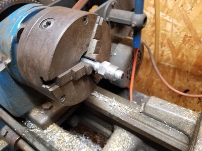

Made a quick arbor out of a old bolt, and rounded off the flat spots of a nut, left and added a taper to one end.

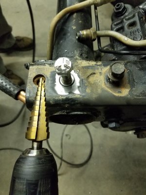

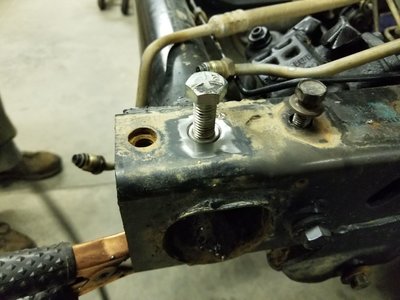

Opened up the hole with a step bit, I was able to leave enough material in the frame to press the nut in with a c clamp.

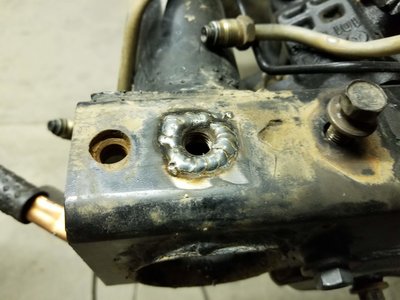

Welded around the edge

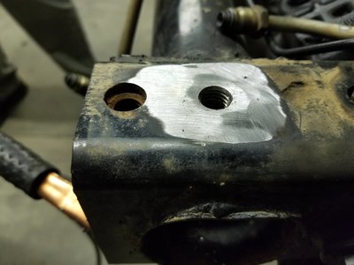

Ground flush to finish.
Quick and easy repair.
