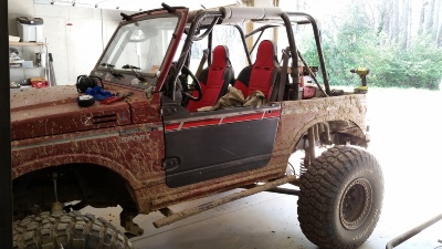

Just before OSCAR last year I rushed to install a windshield fold down and quick removal kit from Roadless Gear (http://www.roadlessgear.com/Suzuki/p/1854/folddown-windshield-kit). I don't have a good picture of the kit, but here's what it looks like removed:

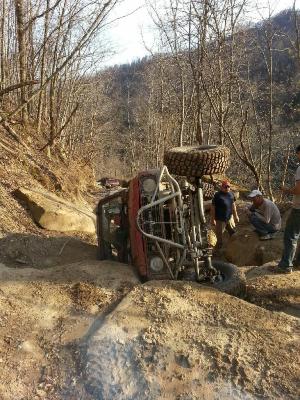

At Harlan last year, this happened:
But the only damage was this and the top:

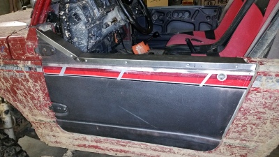

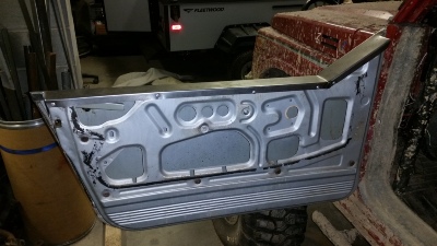

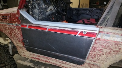

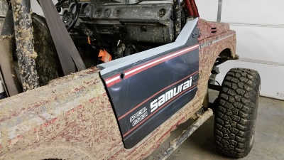

Any time there's the slightest bit of mud on the trail you get coated when your tires are completely outside the body. So, before this trip I decided to make some half doors. I did some trading for a set of rough doors a while back. I chopped them off to match the profile of the tub and mimic a jeep half door. Then I capped the top with some bent sheet metal pop riveted on. It came out better than expected for very little time and about $10 in the project... Only finished one side so far though...
turned out good!
