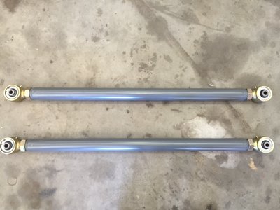

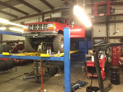

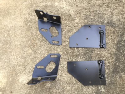

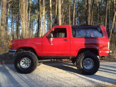

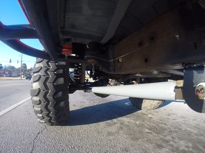

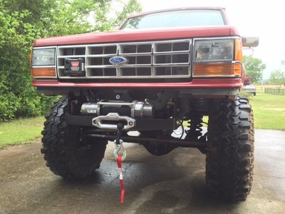

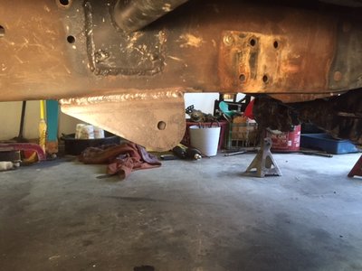

Got my junk back on the road this weekend. Fixed the power steering pump that went out at gulches, new water pump, the impeller came loose from the shaft so it was pumping but kept it at 210 all day instead of 160 like it normally does. Also went ahead and redid the bottom links, .25" wall 2" DOM with 1.25" johnny joints. Redid the brackets on the frame and axle with brackets from barnes. They're alot further out of harms way now, and the ride is alot tighter. The paint has been getting pretty oxidized so I tried waxing it yesterday, normally that ends with me waxing one panel and then not being able to tell the difference so I give up, but I used meguiars ultimate wax and it looks like a brand new truck.
