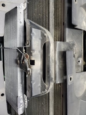

I tackled the trans cooler today. If the truck came with a factory aux cooler (like the 2500 and Burgundy's 1500) this install is easy peasy. Without factory cooler, not so much. I'm not sure why a z71 tow package 4.10 didn't have an aux cooler but here we are.

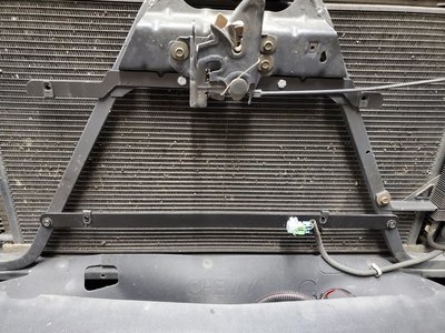

These brackets use the factory hardware, but since this one didn't have the cooler the top holes were just open. I can't remember if they were threaded on the 2500 or just had nut clips on it, but I set a couple 1/4 20 nutserts.

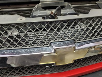

I forgot to take a pic before I snapped the grill back in, but its done. Now she's ready if she gets called in for tow duty.
