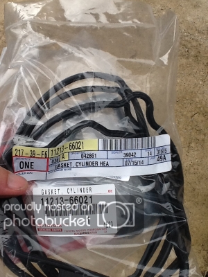

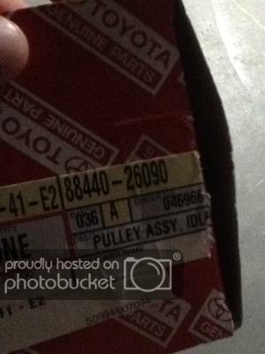

Been tryin to catch up on the maintenance and still has along ways to go, been trying to use OEM stuff. All the cruiser guys think that's the only way to go. I'm starting to see why. These things were $30k+ in 93.this one has 220k miles on all original hoses, plug wires, rotor and looks like belts. I've been collecting a few parts little by little. OEM valve cover gasket, OEM radiator hoses, new OEM a/c pulley. Complete front end rebuild kit. New OEM air filter. Toy parts are alittle more but seems the guy behind the counter is starting to realize ill shop other dealerships if I have to so he's mentioned a few bucks off some things. I think the super budget oriented mechanic is the demise of a lot of vehicles. I'm guilty of it to, calling multiple parts stores looking for the cheapest water pump/alt/starter/ps pump. Sacrificing quality and longevity to save a few bucks.
Also have some G2, 5.29's that will get installed next week I hope. I like the idea of a 10 year warranty.

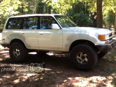

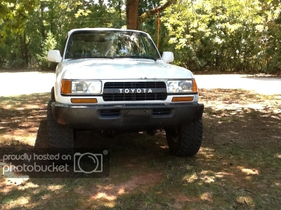

Yup, still has along ways to go. I like it, I mean for a vehicle that just needs a lift and tires it's hard to beat, the elockers and overall toughness. And I only gave $3k for it.

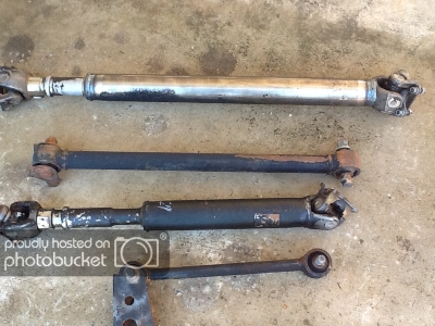

Getting ready for Tellcio this weekend. Being I'm driving it I'm bringing a few spare parts for piece of mind. Have a spare birf, lower link, upper link, front/rear driveshafts. The biggest thing concerning me with driving it is these things aren't plentiful in junk yards, and most parts store basically keep nothing in stock for them.
