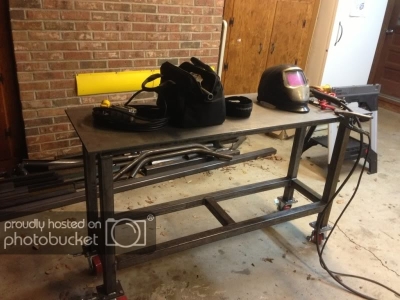

Been working on some stuff around the garage to make my time there more efficient, and allow me to accomplish more on my truck.
First up is a table I built. Top is 19.625" by 60" and 3/8" thick. Base is a frame work of 2x2 11 gauge tubing, and it has 800# casters on it, it's also 37" tall.

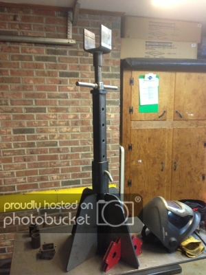

Next up is a set of jack stands. They adjust from 23"-38.75" and the tops are removable for different projects. They also have acme rod adjusters to level them out.
