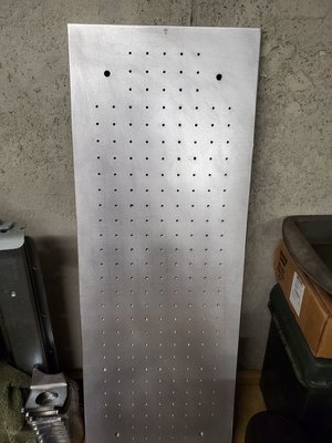

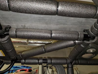

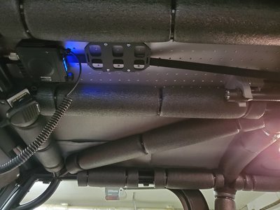

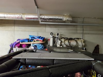

I settled on doing an aluminum plate overhead with a grid of mounting holes to be able to attach pretty much anything, similar to what @Twilliamson did in his jeep. What I was actually doing when I found out my hardtop wouldn't latch with the cage was checking that everything I was doing with the plate cleared.
I'm using tube clamps that are meant to hold a light bar to mount it. I tapped the plate for the mounting bolts.

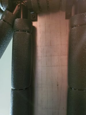

Now to draw out the grid and get to drilling and tapping.
#10

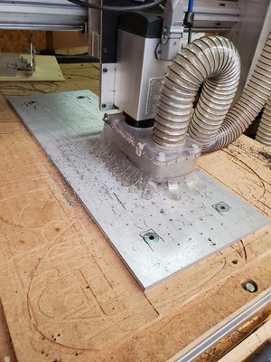

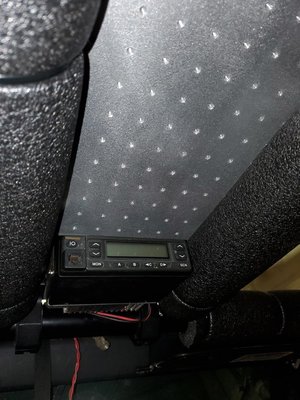

I went over to Tripp's today and we drilled and tapped the grid in the plate. I have a little bit of cleanup work to do, then can lay out what's being mounted on it.

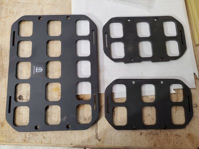

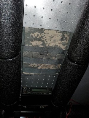

I had an epiphany today. The picture is a MOLLE admin pouch and it fits pretty well between the tubes. Then I found a company with blemish rigid MOLLE panels. I'll put a MOLLE panel on it with a small standoff, then i can add any combination of accessories (pouches, etc.) for sunglasses or whatever. It won't be lockable, but much more functional and customizable.
