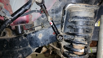

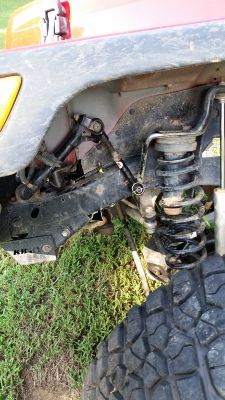

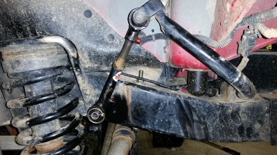

Second was mounting the storage pins for the JKS disconnects. When I first put on the disconnects, I mounted the pin on one side but the tire got in to it. I gave up finding a suitable location and have been using zip ties. I had been looking at it again and thought I could make them work. My first spot tonight I neglected to check for interference with the links when they were connected. So, third time is a charm.
With as little lift as I have, and the 35x12.50s with minimum backspace, this is the only place I could find that the tire can't get them.

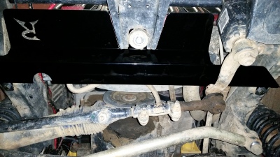

So the added item... I have a pop in the steering that happens at the extremes. Full left and it will pop once, if you turn back a little and full left again, it will not pop. Full right and it pops, again will only do it once until it pops going the other way. It sounds like its in the lower joint of the steering shaft or the box.
I would take a REAL close look at the track bar.
Dad, Burgundy, and I have all been under it multiple times while someone else turns the wheel, hands on everything, and can't feel it. When checking from the bottom the sound comes from right behind the box skid. When listening from the top, its coming from below the coolant bottle. I'll check the upper track bar mount one more time, but I don't think that's it.
I drove it to work today and by the time I got in the parking garage the pop was much more frequent. I ran it over to CFS at lunch and they quickly diagnosed it as the frame side track bar bolt. Jason backed it off and ran it down again and no more clunk. I checked it and even put a wrench on it, but I guess I need a bigger wrench.

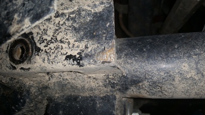

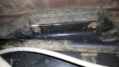

At full bump in the rear the track bar hits the mounting flange on the new gas tank skid. I think I can trim it a little. Also the front track bar hits the axle side mount a little. I plan to work on those minor issues and be ready to go to Windrock.

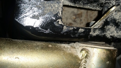

I actually got to get under the jeep a little bit today and both track bar clearance issues were easily resolved. The mounting holes on the tank skid are slotted so I was able to loosen thr nuts, push the mounting flange back, and tighten. You can see where the track bar was hitting.
The front took a sledge and a flap wheel, but made a little more clearance.
Where it was hitting
Little bit of room now.

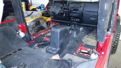

Old seats are out and sliders are separated, ready for the Corbeaus and adapters.
Drove the jeep to Charleston this weekend. I was pretty surprised how well the stock seats did. I used to hate the 03 and up seats but I guess I don't fit em like a used to.
