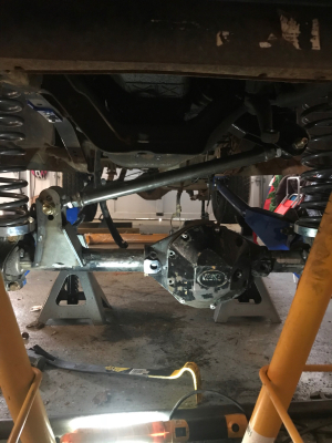

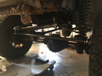

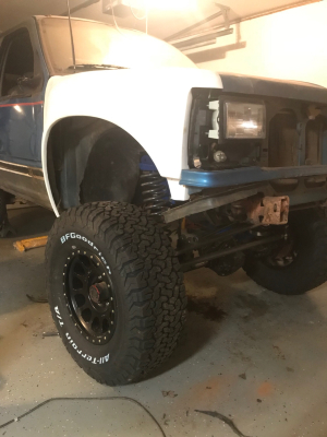

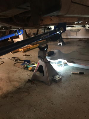

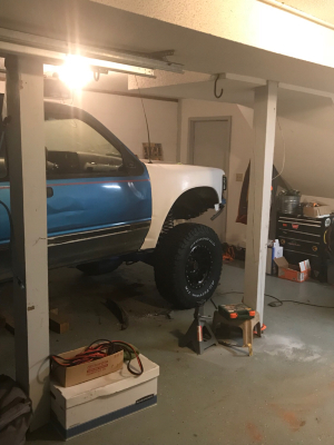

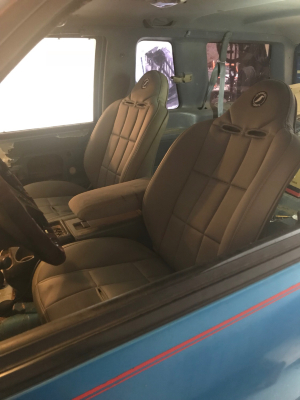

Haven’t updated in a while but have been busy. Most of the interior is gutted and have the seats bolted in to check for fitment. Sliders the console and the sliders are smooth. Found some sockets and a floppy disc from under the rear carpet so that was interesting. Got the front end all mounted underneath and steering mocked up. Need to rearrange some misalignments and other odds and ends but it fits nicely. Ordered a double bolt high steer arm from artec to bump the drag link out. Got a fender mounted tonight as well...getting antsy to jump it haha. f59dcc0b09163b6ffeb5f01c48c2c6e8.jpg

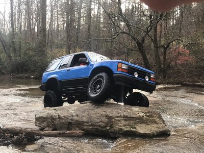

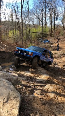

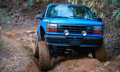

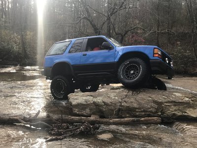

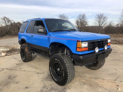

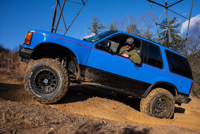

Haven’t posted here in awhile... nothing really I would change to be honest. I’ll eventually do an anti rock, air bumps, and probably a strong box (bw1354 crawl box 5:1 low). For now I really enjoy driving the darn thing. I’ve put around 6k miles on it since I finished it and it’s worked really well. I’ve been 3+ hours from home with it camping and mountain biking. The truck rides good and the heated seats are super comfy.

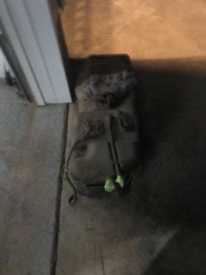

Started Harlan prep tonight. New fuel pump. Gauge hasn’t worked and it’s seems to be losing prime here lately. Don’t want it failing far from home. Gives me an opportunity to route the arb diff breather and air locker lines like a really wanted as well.
