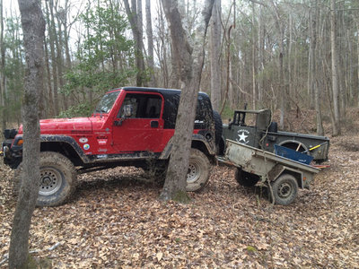

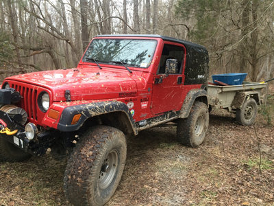

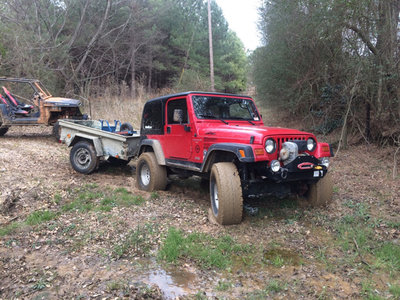

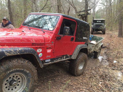

Had a great time out there saturday. Ended up pushing the All terrains to the limits out in the back 40. I also permanently attached my trailer to my hitch ball.... Going to have to do something about that. Thanks for all the help modifying my steering. And for the tech lesson on using a triangle file from Jody and Tim. I filed the 4 double splines out of my pitman arm so it can be clocked 360* and now my steering wheel is centered AND i have full steer to both sides. Thanks again guys!
