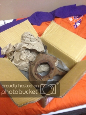

I actually looked this up last night and have it pulled up on my computer. I found two places that will do it 50-60 bucks I believe. One of which is the company that makes the high steer arms like brooks has, google behind the axle high steer Dana 44 and it should come up. Thinking they say throw knuckle or knuckles in a flat rate box ship it to them and it usually goes back out within 24 hrs.

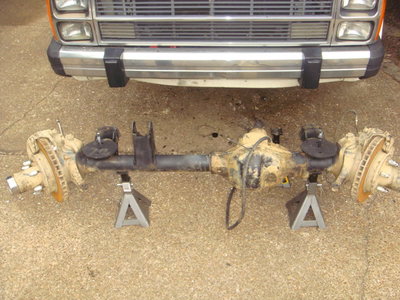

This is the Company that made my arms:
http://www.harshterrain.com/services/
This is the arm setup I have: (2nd one down)
http://www.harshterrain.com/parts/Steering/Dana_44_or_GM_10_Bolt/
I'll try to find some of mine after lunch.

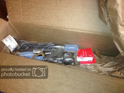

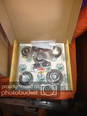

well the parts are starting to come in now.
gears, install kit and chromos should be here today, but not sure if i will have left for columbia before they get here.

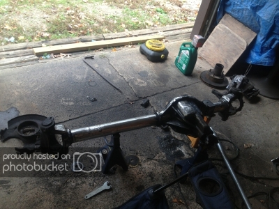

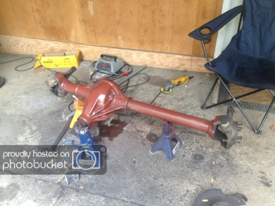

did a little work to the 44 this morning. Cut the old brackets and cleaned her all up. she was a beauty under neither all the oil on it!
gonna try and get the old ball joints pressed out of the chevy 44 today, then most likely call it a day.
anyone else see the all the road grime all over the floor?? :D
#73
looking good, those balljoints were the most rusted I have ever seen.

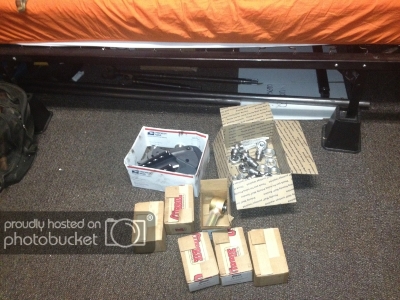

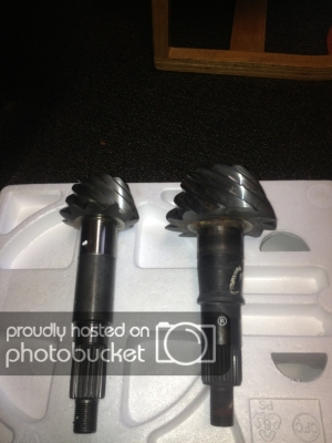

all my parts came in today
and this comparison doesn't show too much. but that is a stock 3.73 8.8 pinion next to the new 44 pinion. You can see the contact patch on the 8.8 is much bigger, and the pinion shaft is bigger too. so that shows the reason on why i personally chose an 8.8 in the rear of mine over a 44. obviously the 8.8 pinion head is going to be much bigger cause there are more teeth on a 3.73 pinion than a 4.56 pinion though
now time to just play the waiting game until i can build it and get it in. still got a few more parts to get such as diff cover, spring perches and synergy high clearance lower frame mounts.
