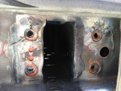

Cracks welded up

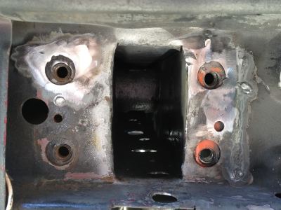

Ground flush

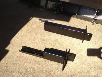

Framerail inserts all welded up to the Rigidco Bumper brackets, which bolt to the 4 stock mounts and the 4 frame rail holes, which is also bolted to the bumper subframe mounts
We got lucky welding those up. I already had them in the frame rails for 2 months bare metal on the weld surface. This left a perfect little outline on the back of the rigidco mounting plate, so tack and test fit went pretty smoothly with only 3 testfits and adjustments on the pass side, and only one on the driver side

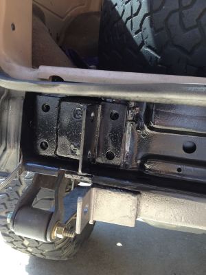

Here they are inserted

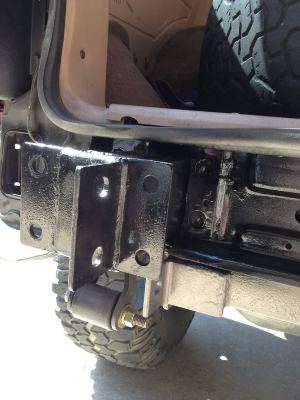

And all the way in
Everything lined up really well and bolted back together easily. It's probably overkill, but I feel a lot better with the cracks welded up. Joe did a great job with the welds. He didn't has a lot of experience welding to the thin gauge of the unibody, but once dialed in, the welds turned out great.

Cracks welded up
Ground flush
And all the way in
