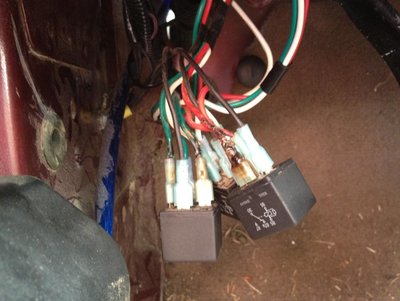

Our plan is definitely now (due to some IDIOTIC WIRING IN MY JEEP that I have to fix) will be to leave late thursday night so we get there at first light friday, set up camp, and start wheeling. I f things go better than expected we might get out of here early enough to make it there in time to get some sleep thursday night. Either way Marcus I'll be giving you a call tomorrow to go over last minute details.
#56
Not sure why it posted a million times.......but you get the gist. I think I traced the problem with the melted wiring back to the fact that (think christmas tree) all of the "power" sources were daisy chained, with only one fuse.............. ARGH!!!!!!!!:pissed:
#57
Well, DEFINITELY NOT. Yes, I fixed the auxiliary lighting issues, and they are all wired up and working........but now for some ungodly reason my rear lights (just the running and blinkers) aren't working......the brake lights do.....I'm researching it now, but I can't for the life of me figure out what one would have to do with the other!!!!!
#60
Pretty much I'm an idiot and forgot about one little screw up in the front that was the grounding point for about 5 things, 3 of which I removed (the melted relay's) and the other two....welll,........i just forgot about.
