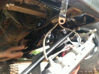

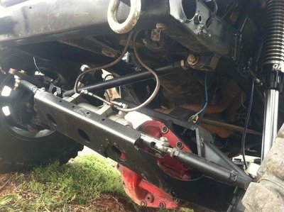

Everything is pretty much done less the end cap on pass side, new lower heims to replace bushings on axle side, and the tie in to the ram mount. Should be all finished up this week.
Still waiting on body armor and what not from the paint shop. Hope to get that this week. Then next weekend play with shocks and put all armor an stuff back on. Then it will be picture time then beat down time at Oscar.

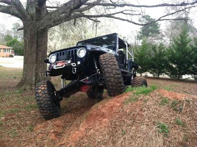

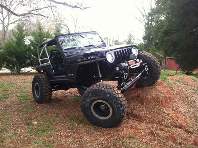

Pics don't really show what I was after but there is about 6" of room at full stuff. Shocks have about 3.5" showing still but the bottom out point on an ORI is still 5/8" of shaft showing. Needless to say, there is plenty of room for up travel. Should be no issues with interference.
I'll try to take some legit non camera phone pics when I get it completely done this week.
