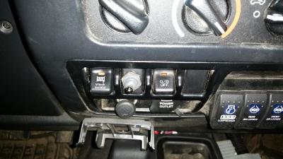

Have you seen where mine are mounted? They're in the blank panel that I think is where the ash tray would be.

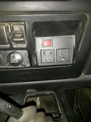

Are you talking about this spot? The PO has a 400W inverter under the seat. Just to the left of the picture is the location of the wiper and washer switches for my long gone hard top. I may remove them and replace with what I need.

Yes. There's a seller on ebay that has switches that fit those slots like the winch isolator in mine. You can get them labeled for front and rear locker.
Search for oem tj rocker switch.
#9
Nice call Larry! I have 2 OEM style Diff Locker switches on the way. That will work out nicely and leave a spot for another switch later.
