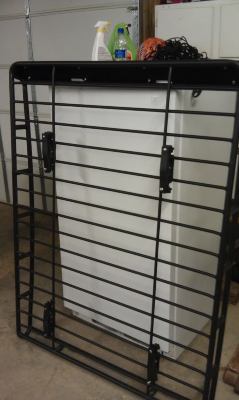

I found a good deal on a safari rack and picked it up today, so now I'll just do a plate mounted to the basket.

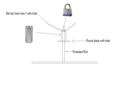

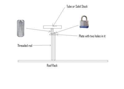

So I'm going with tire on the roof in a safari rack. I plan to mount a plate to the rack with threaded rod through centre of wheel.
I need ideas on how to make a lockable t handle or Y handle to tighten down on the wheel.
the plate with two holes holds the rim down. The threaded rods go through the center of the rim.
or you could simplify it and put the hold in the middle of the single threaded rod
